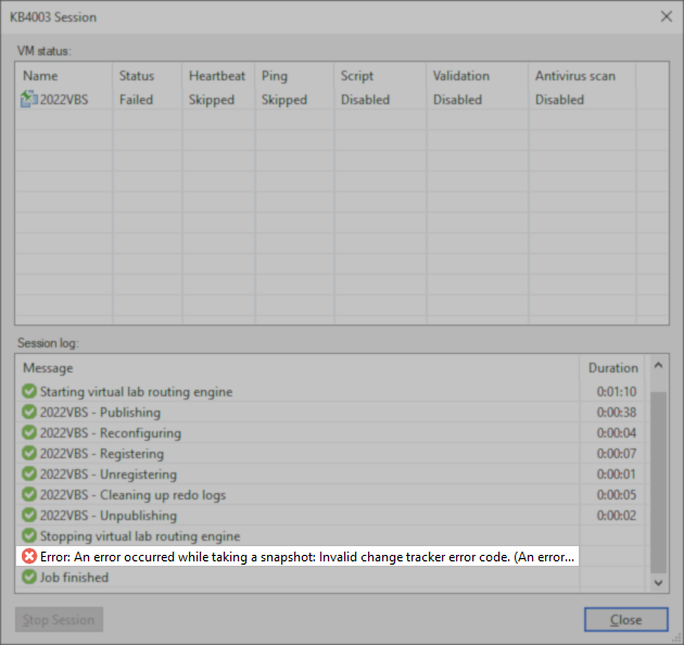

A SureBackup job testing a VMware VM that has Virtualization-Based Security (VBS) enabled fails with the error:
An error occurred while taking a snapshot: Invalid change tracker error code. (An error occurred while taking a snapshot: Invalid change tracker error code.)

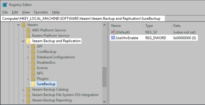

To resolve this issue, create the following registry value on the Veeam Backup Server.
When set to '0', this registry value will force SureBackup to not change 'vhv.enable' to false within the VMX of VMs it tests.
This registry value will take effect on the next run of the SureBackup job.
Key Location: HKLM\SOFTWARE\Veeam\Veeam Backup and Replication\SureBackup
Value Name: UseVhvEnable
Value Type: DWORD (32-Bit) Value
Value Data: 0
Note: The key SureBackup does not exist by default; it must be created, and then the value must be created within it.
regesitry example
