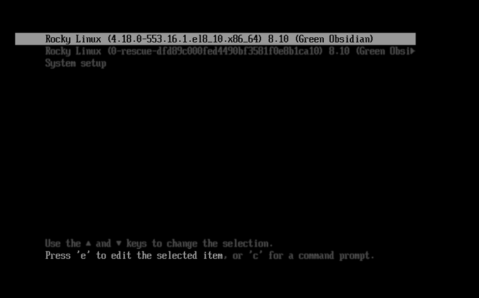

- As the VM boots, hold [Shift] or tap [ESC] to open the GRUB menu.
- When the GRUB menu appears, select the top entry and press the e key to edit the boot parameters.

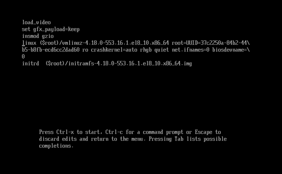

- Find the line that starts with linux
- Press the End key on your keyboard to jump to the end of this line.
- At the end of the line, add: rd.break

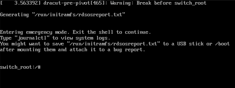

- Press CTRL+X to boot with the modified parameters.
- The VM will now boot and enter emergency mode.

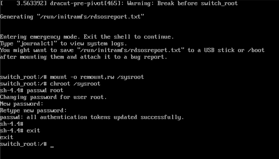

- Use the following commands to mount the system, chroot into it, and reset the password for the root account:
mount -o remount,rw /sysroot
chroot /sysroot
passwd root
exit
- Once the password is updated successfully, reboot the Worker appliance.
