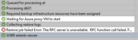

When attempting to add an Azure Restore Proxy Appliance to Veeam Backup & Replication or performing a Restore to Microsoft Azure using an Azure Restore Proxy Appliance, the following errors may occur:
When attempting to add an Azure Restore Proxy Appliance:
Failed to save Azure proxy. Error: The RPC server is unavailable.  Function name: [GetSvcVersion]. Target machine: [<IP Address>:6160].
Screenshot of failed to save errror
Restore job failed Error: The RPC server is unavailable.  RPC function call failed. Function name: [InvokerTestConnection]. Target machine: [<IP Address>:6162].
Proxy Failure
Note: This article is regarding the Azure Restore Proxy Appliance, which is used to help speed up the restore process, not to be confused with the Azure Helper Appliance, which facilitates the restore Linux workloads to Microsoft Azure.
