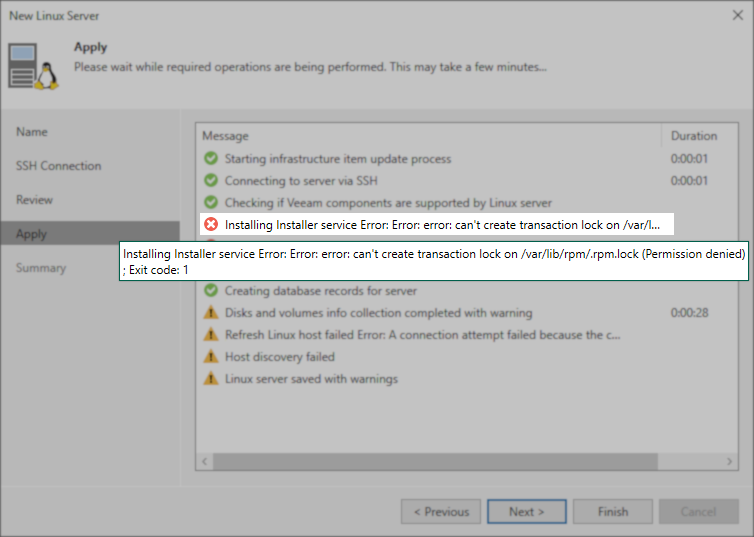

When adding a Linux Server to Veeam Backup & Replication using a non-root account and not enabling the "Elevate account privileges automatically" option, the following error is shown:
  • RPM-based Linux distributions
    Installing Installer service Error: Error: error: can't create transaction lock on /var/lib/rpm/.rpm.lock (Permission denied)
    • Exit code: 1
Installer Install Fail

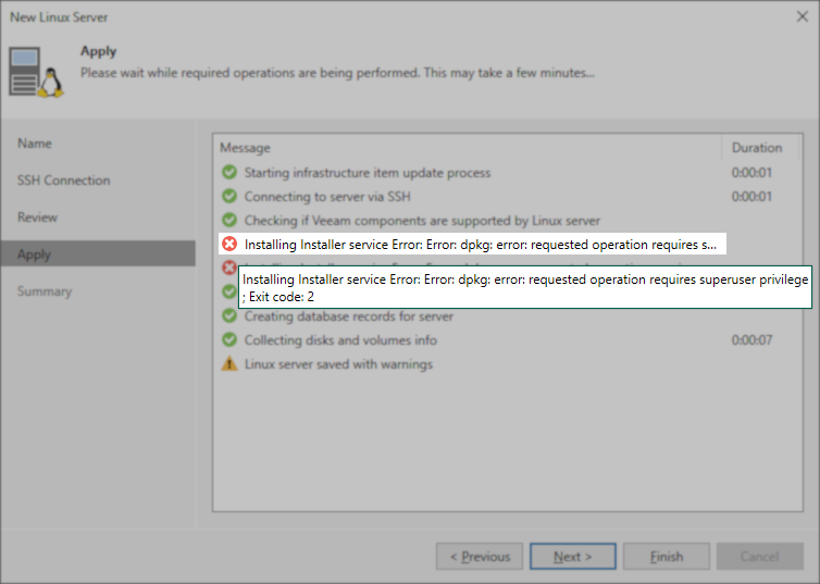

  • Debian-based Linux distributions
    Installing Installer service Error: Error: dpkg: error: requested operation requires superuser privilege
    Exit code: 2

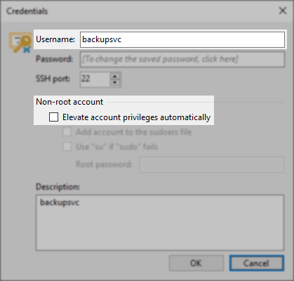

Example of Non-root with no elevate
Example of a credential configuration that will cause the error.
Cause
This error occurs when the account specified on the SSH Connection page of the 'New Linux Server' or 'Edit Linux Server' wizard is a non-root account with the option "Elevate account privileges automatically" not selected. Which is required for the persistent Veeam Data Mover service to be installed.
