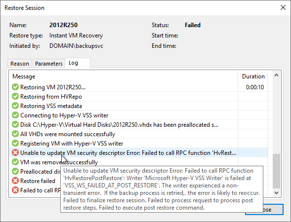

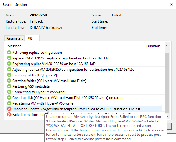

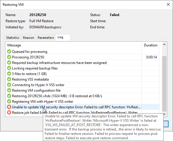

A Full VM Restore, Instant Recovery, or Failback of Hyper-V VM with Configuration Version 5.0Configuration Version 5.0 was first introduced with Server 2012 R2 Hyper-V. to a Hyper-V host running Server 2022 fails with the following error:
Unable to update VM security descriptor Error: Failed to call RPC function
'HvRestorePostRestore': Writer 'Microsoft Hyper-V VSS Writer' is failed at
'VSS_WS_FAILED_AT_POST_RESTORE'. The writer experienced a non-
transient error. If the backup process is retried,. the error is likely to reoccur.
Failed to finalize restore session. Failed to process request to process post
restore steps. Failed to execute post restore command.

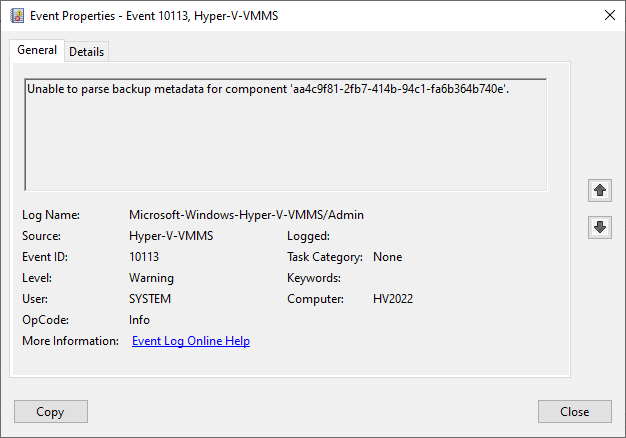

When the restore or failback operation fails to complete, the following events can be observed within the VMMS Events on the destination Server 2022 Hyper-V host:
Event 10113, Hyper-V-VMMS
Unable to parse backup metadata for component '<VM-guid>'.
Event 10113

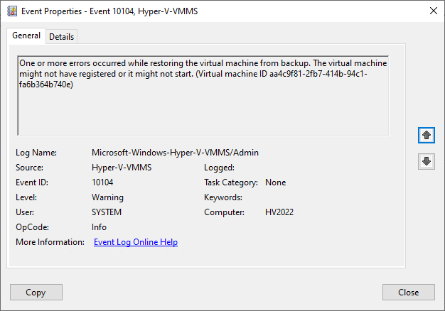

Event 10104, Hyper-V-VMMS
One or more errors occurred while restoring the virtual machine from backup. The virtual machine
might not have registered or it might not start. (Virtual machine ID <VM_GUID>)
Event 10104
