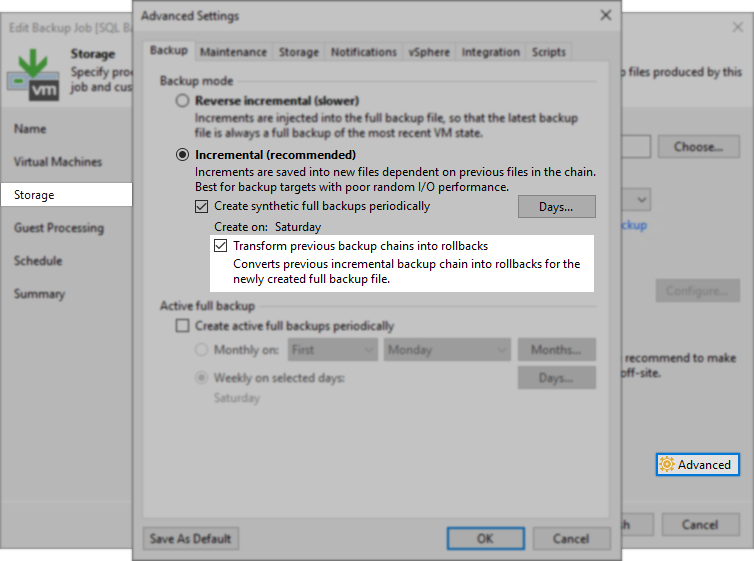

  1. Edit a Backup Job
  2. Go to the Storage tab
  3. Click Advanced in the bottom-right corner
  4. On the Advanced Settings > Backup tab, check if the option for "Transform previous backup chains into rollbacks" is checked.

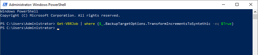

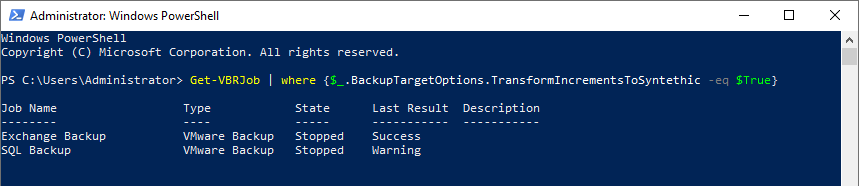

Run the following command in a PowerShell prompt on the Veeam Backup Server to pull a list of all jobs using Transform previous backup chains into rollbacks.
Get-VBRJob | where {$_.BackupTargetOptions.TransformIncrementsToSyntethic -eq $True}
No Transforms
An empty result means no jobs need to be modified.
Transformers
Any Job listed must be reconfigured.

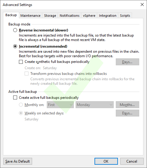

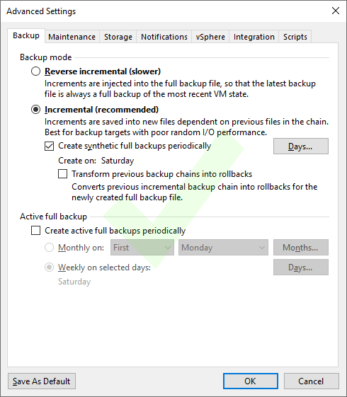

  • Switch to Synthetic Fulls only by disabling "Transform previous backup chains into rollbacks." This will cause the job to periodically create Synthetic Fulls, increasing repository storage usage due to how the Forward Incremental retention policy operates.
    or
  • Switch to Forever Forward Incremental by disabling "Create synthetic full backups periodically," which will also disable "Transform previous backup chains into rollbacks." Using Forever Forward Incremental will maintain the same space usage as "Transform previous backup chains into rollbacks" but using a different retention method.

  4. On the Backup tab, configure the job to use either:
    • Forward Incremental with Periodic Synthetic Fulls
      or
    • Forever Forward Incremental
No
This configuration is incompatible with Veeam Backup & Replication 12.
Synthetic Full
