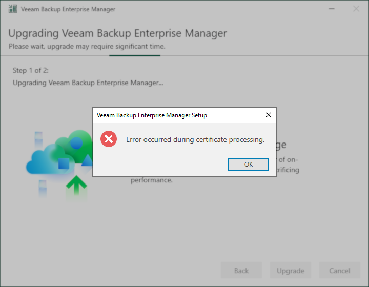

When attempting to upgrade an existing Veeam Backup Enterprise Manager deployment to version 12.2, the installer fails, displaying the error:
Error occurred during certificate processing.
Error

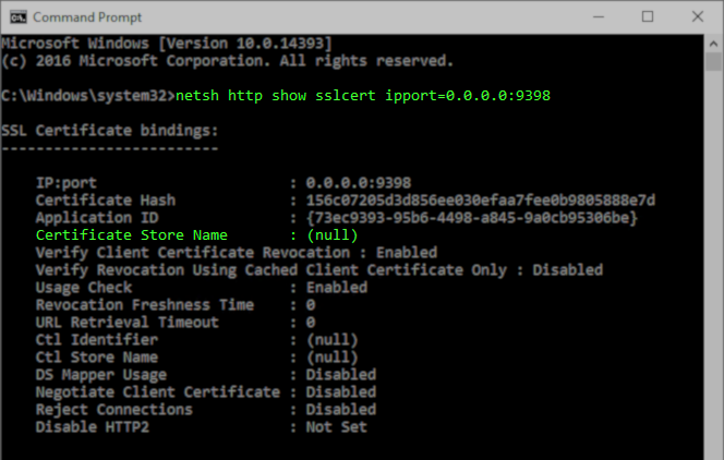

Part 1: Review TLS Certificate
Review the existing TLS certificate and identify if the Certificate Store Name value is (null) using the following command:
netsh http show sslcert ipport=0.0.0.0:9398
Null Cert Store The (null) value for the Certificate Store Name causes the upgrade error.

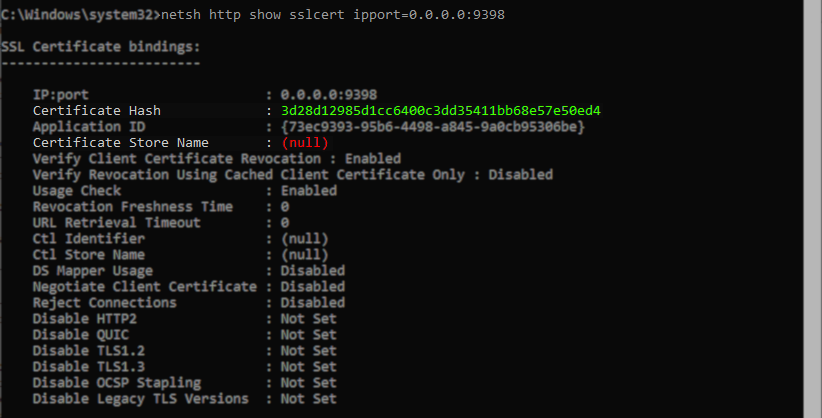

If the Certificate Store Name is listed as (null), you must rebind the existing TLS certificate so that it has the Certificate Store Name explicitly specified.
  1. Review the existing certificate and take note of the Certificate Hash value.
