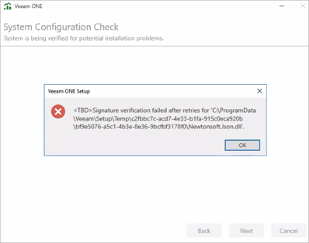

When attempting to upgrade or install Veeam ONE 13, the System Configuration Check stage of the setup wizard fails, and the following error is displayed:
<TBD>Signature verification failed after retries for 'C:\ProgramData\Veeam\Setup\Temp\c2fbbc7c-acd7-4e33-b1fa-915c0eca920b\bf9e5076-a5c1-4b3e-8e36-9bcfbf3178f0\Newtonsoft.Json.dll'.
