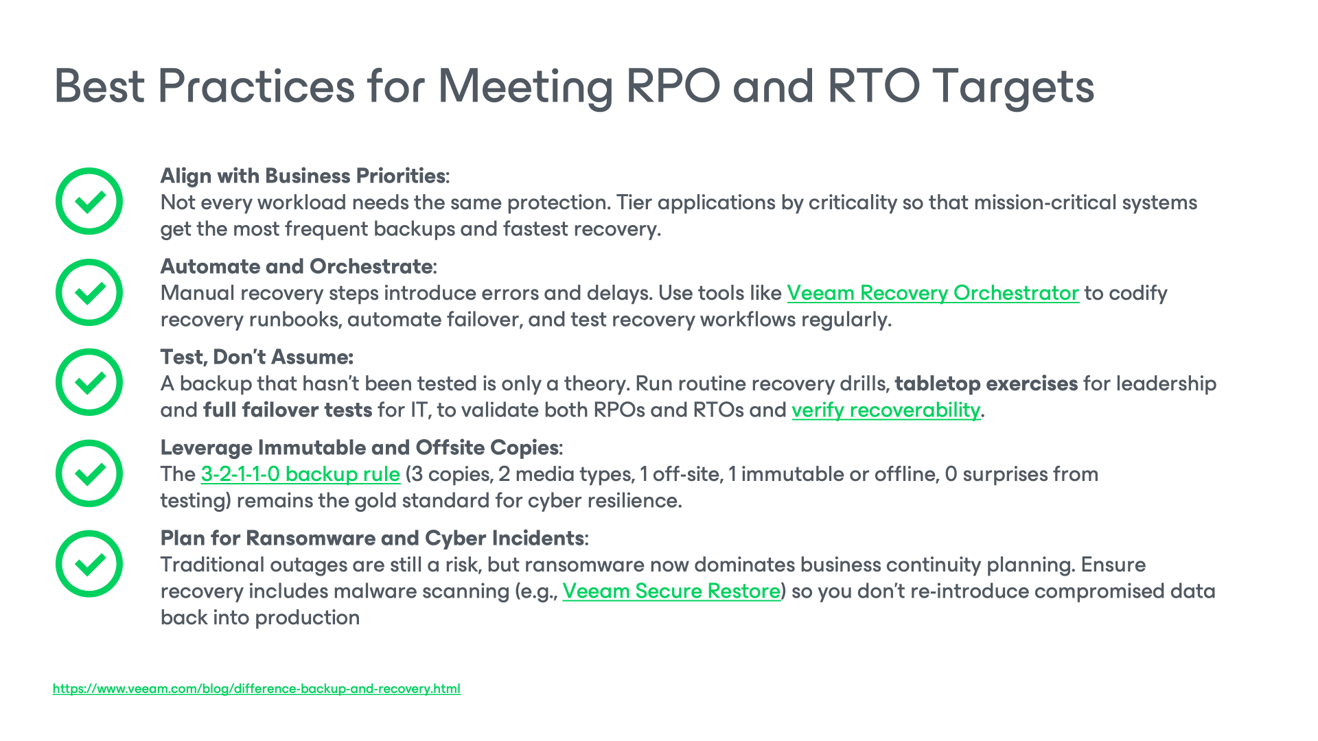

Best Practices for Optimizing RPO and RTO
Achieving aggressive RTO and RPO targets requires a smart mix of technology, process, and ongoing validation. To optimize RPO and RTO, apply the following best practices:
Frequent Backups
To achieve environments with incredibly low RPOs, Veeam’s Continuous Data Protection technology and other application-aware backups or incremental backups can be utilized for frequent snapshots. For less critical applications, set an appropriate backup frequency. Automate the backup process, including testing the integrity of the copy, for peace of mind.
Frequent full backups carry a significant overhead in terms of storage costs. Incremental backups reduce the cost by recording what changed between each backup.
Keep multiple backups on different types of media. Ideally, you should also have an immutable off-site backup to protect against data loss from malware or ransomware attacks.
Redundancy and Failover
Minimize downtime with redundancy and failover for critical services. This practice isn’t a substitute for backups, but it can protect against application failures or outages that would otherwise interrupt service.
Using certain RAID arrays can offer a layer of redundancy, which can reduce the risk of data loss and allows you to respond to hardware failures. Again, this is simply an extra layer of protection and not a replacement for backups in your business continuity plan.
Even when data and workloads are replicated across redundant cloud environments, challenges remain, particularly the risk of data corruption or encryption caused by ransomware. Replication alone ensures availability, but it can also replicate compromised data if threats go undetected. To address this, organizations need a combination of real-time protection and immutable recovery points.
What to consider:
  • Recognize replication limits: Replication preserves availability but can also copy corrupted or encrypted data.
  • Maintain multiple recovery points: Keep several restore versions to ensure access to clean data.
Use immutable or protected storage: Prevent modification or deletion of critical recovery data.
Testing & Validation
Evaluating RPO vs. RTO priorities and setting objectives is just the beginning. To have confidence in your organization’s ability to meet those objectives, any backup and recovery practices must be tested regularly.
There are many best practices for testing recovery objectives, but the most important practice is to actually perform those tests. Investing in the resources and time required to complete the testing process is essential. Also keep in mind that adequate testing can require storage, compute, networking, and time.
Consider the following when planning recovery tests:
  • The best testing schedule to meet SLA requirements
  • The time required to recover the data or workload to an operational state
  • Storage requirements for data recovery
  • Storage and compute requirements for critical workloads
  • Automation and orchestration tools to ensure tests can be customized and performed without errors
Priority Based Recovery
Consider which workloads are mission critical and prioritize these when developing a recovery strategy. Running critical applications in virtual machines can help hasten the recovery process. For example, recovering customer data or financial records would be a higher priority than restoring a database of internal training materials.
Automation
Automation allows backups to be made without human intervention. Scheduled backups reduce the risk of data loss. Modern data protection tools support automated testing and orchestration, giving peace of mind that backups are error-free and recoverable.
Don’t treat having automatic backups as a chance to get complacent. Review your backup processes regularly to confirm they cover all business-critical data.
Offsite Storage
Follow the 3-2-1 backup rule:
  • There should be three copies of the data
  • On at least two different media
  • With one copy being off-site
This ensures the data is protected not only against accidental deletion or corruption but also against loss through catastrophic events, such as fires or floods, which could destroy an on-site copy held on removable or NAS storage.
Best Practices for meeting RPO and RTO targets.

Continuous Data Protection (CDP) which captures changes in real time for near‑zero RPO.
Disaster Recovery Orchestrator automates failover and testing.
Immutable backups ensure clean recovery points protected from ransomware.
