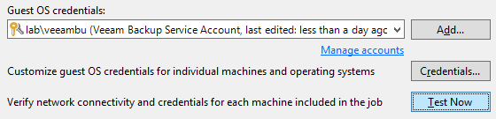

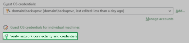

When using the 'Verify network connectivity and credentials' feature on the Guest Processing tab of a job, an error or warning is observed.
Note: Prior to Veeam Backup & Replication v13, the button was simply labeled "Test Now".
The credentials section of a Veeam interface shows a selected account for Guest OS credentials. Below it, the "Verify network connectivity and credentials" button is highlighted.

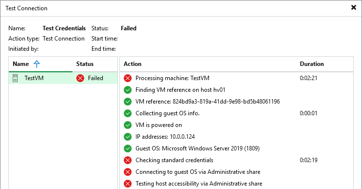

The "Test Connection" results window shows the status as "Failed" for testing credentials on a machine named "TestVM." The action log lists successful steps for finding the VM and collecting guest OS info, but errors for checking standard credentials, connecting to the guest OS via administrative share, and testing host accessibility.

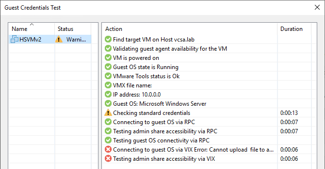

Regarding Warning in VMware Environments
In VMware environments, Veeam Backup & Replication can use two methods to connect to a guest: RPC or VIX. If RPC is testing successfully, it is generally acceptable for the VIX test to fail as it will not likely be used. However, if it is desired to have VIX succeed, please see the relevant section at the bottom of the solutions section.
VIXWarning

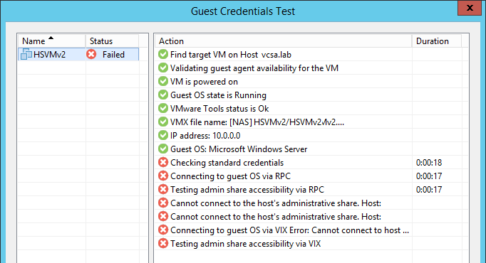

Testing admin share accessibility via RPC Errors
The following are a few of the possible errors that may be seen in the Guest Credentials Test in the line after "Testing admin share accessibility via RPC"

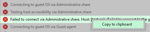

Screenshot demonstrating how to right-click on an entry in the staistics window and select the Copy to Clipboard option.
Right-click on the line item and copy it to the clipboard so that you can paste it somewhere else to see the full error.
Win32 error:The network path was not found.; Code: 53
Cannot connect to the host's administrative share. Host:  [DC01]. Account: [lab\veeambu].;Win32 error:The network path was not found.; Code: 53;
This issue is covered in https://www.veeam.com/kb1230
Win32 error:Access is denied.; Code: 5;
Cannot connect to the host's administrative share. Host: [DC01]. Account: [HSVMv2\veeam].;Win32 error:Access is denied.; Code: 5;
"Access is denied" may occur if either:
  • The account used to initiate Guest Processing is not a member of the Administrators group on the protected machine.
    For more information, review the Guest Processing Required Permissions.
  • The account used to initiate Guest Processing is a local account other than the Administrator account (local accounts other than the Administrator account are blocked from remote logon by default).
    The issue of remote login using local accounts is covered in detail here: https://www.veeam.com/kb4185.
    The user account used to connect to the remote machine must work with the default UAC remote restrictions, meaning that the account must be either:
Win32 error:The user name or password is incorrect.; Code: 1326;
Cannot connect to the host's administrative share. Host: [DC01]. Account: [lab\veeambu].;Win32 error:The user name or password is incorrect.; Code: 1326;
Check that the account specified can connect to the Host specified in the error. If that account should be able to connect, open the Credentials Manager in Veeam Backup & Replication and update the password.
Win32 error:The trust relationship between this workstation and the primary domain failed.; Code: 1789;
Cannot connect to the host's administrative share. Host: [DC01]. Account: [lab\veeambu].;Win32 error:The trust relationship between this workstation and the primary domain failed.; Code: 1789;
Test logging into the Host specified in the error with the Account specified in the error. Likely the same error will occur.
To correct this error, repair the trust relationship in Active Directory.
Connecting to guest OS via VIX Errors
VIX is a network-less alternative method for Veeam Backup & Replication to connect to a guest. This functionality only exists when processing a VMware Virtual Machine.
Cannot upload file to admin share
Connecting to guest OS via VIX Error: Cannot upload file to admin share [C:\Windows]. Could not create guest directory [C:\Windows\VeeamGuestHelpersTest] Could not create guest [vm-431254] directory [C:\Windows\VeeamGuestHelpersTest] Could not invoke guest operation Unable to access file C:\Windows\VeeamGuestHelpersTest
This issue is covered in https://www.veeam.com/kb1788
Could not validate ... credentials for guest
Connecting to guest OS via VIX Error: Cannot connect to host [vcsa.lab] over web services. Login: [vsphere.local\administrator]. Guest Login: [lab\veeambu].
Could not initiate Web Service connection
Could not initiate guest virtual machine [vm-431254] with user [lab\veeambu]
Could not validate host [https://vcsa.lab/sdk] credentials for guest [vm-431254] user [lab\veeambu]
A general system error occurred: vix error codes = (1, 0).
This error means that when Veeam attempted to connect to the guest via VIX the account provided was unknown to the guest.
Possible causes include:
  • password for the account is wrong.
  • account specified does not have ability to connect to the guest.
  • account being used is a domain account and the guest is not on the domain
  • trust relationship between the guest and the domain is broken
