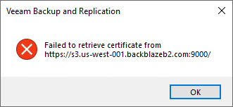

When adding an Object Storage Repository or interacting with an existing Object Storage Repository the following error occurs:
Failed to retrieve certificate from ...
The format of the error is different for each type of Object Storage Repository:

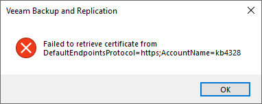

Region: Azure Global (Standard)
Note that the Azure endpoint URL is not detailed in the error when adding/interacting with Azure storage using the Azure Global Region. When using Azure Gov or Azure China, the error will contain the entire endpoint URL, as seen with AWS or S3-Compatible. To identify the specific Azure endpoint URL when using the Azure Global Region, check the Azure management portal or review the log investigation advice in the More Information section of this article.

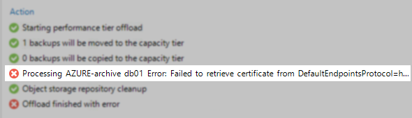

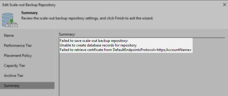

Below are examples of this same "Failed to retrieve certificate" error occurring during an Offload task and when editing a Scale-Out Backup Repository.

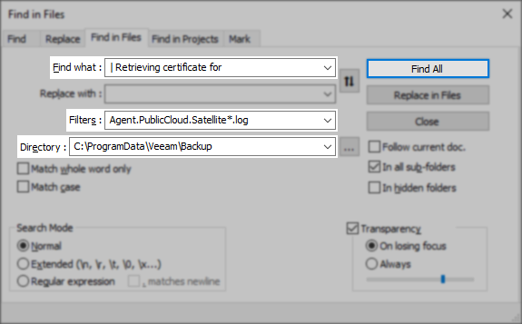

To simplify finding the endpoint information, search the Satelite log for:
