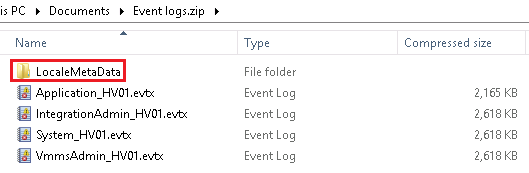

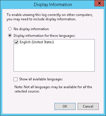

Note: To ensure that all events in an .evtx file can be read on other machines, the .evtx must be exported with the Display Information. Failure to include the Display Information may delay the investigation of the support case.
Store each machine's exported CSV files in a single ZIP or 7z archive and attach them to the support case.
