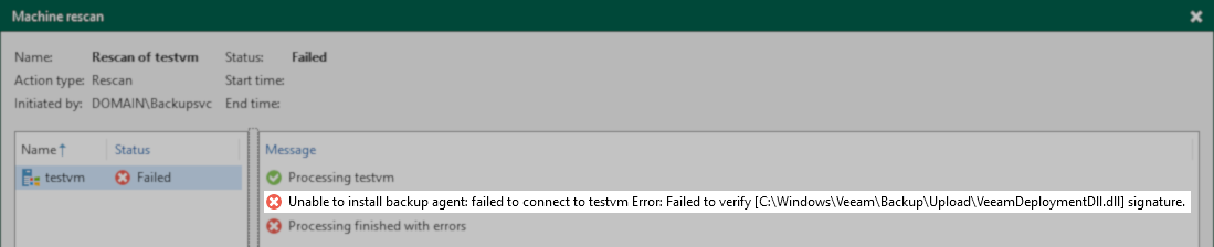

  • When Veeam Backup & Replication is attempting to install Veeam Agent for Microsoft Windows backup agents on a machine the procedure fails with:
    Unable to install backup agent: failed to connect to <hostname> Error: Failed to verify [C:\windows\Veeam\Backup\Upload\VeeamDeploymentDll.dll] signature.
failed to verify error

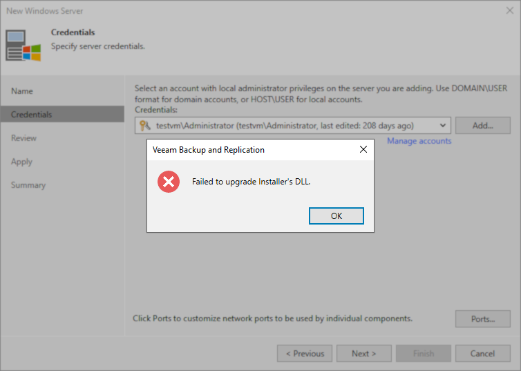

  • When attempting to add a Windows machine to the Managed Servers section of Veeam Backup & Replication, the New Windows Server wizard displays the error:
    Failed to upgrade Installer's DLL.
failed to upgrade
