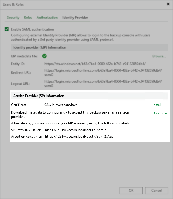

SAML Authentication May Stop Working
After the host name of the Veeam Software Appliance is changed, the Service Provider (SP) information will change.
There will be a new SP Entity ID and Assertion Consumer Service URL. These should be updated on the Identity Provider side, either manually or by using the Download option within the Veeam Backup & Replication console to then upload the new SP metadata.
The "Identity Provider" tab of the "Users & Roles" settings window is shown, with SAML authentication enabled. The screen displays identity provider (IdP) information such as Entity ID, Redirect URL, and Logout URL. Below, a highlighted section labeled "Service Provider (SP) information" provides certificate details, download links for metadata, and manual configuration values including SP Entity ID / Issuer and Assertion consumer URLs. The OK and Cancel buttons are visible at the bottom.

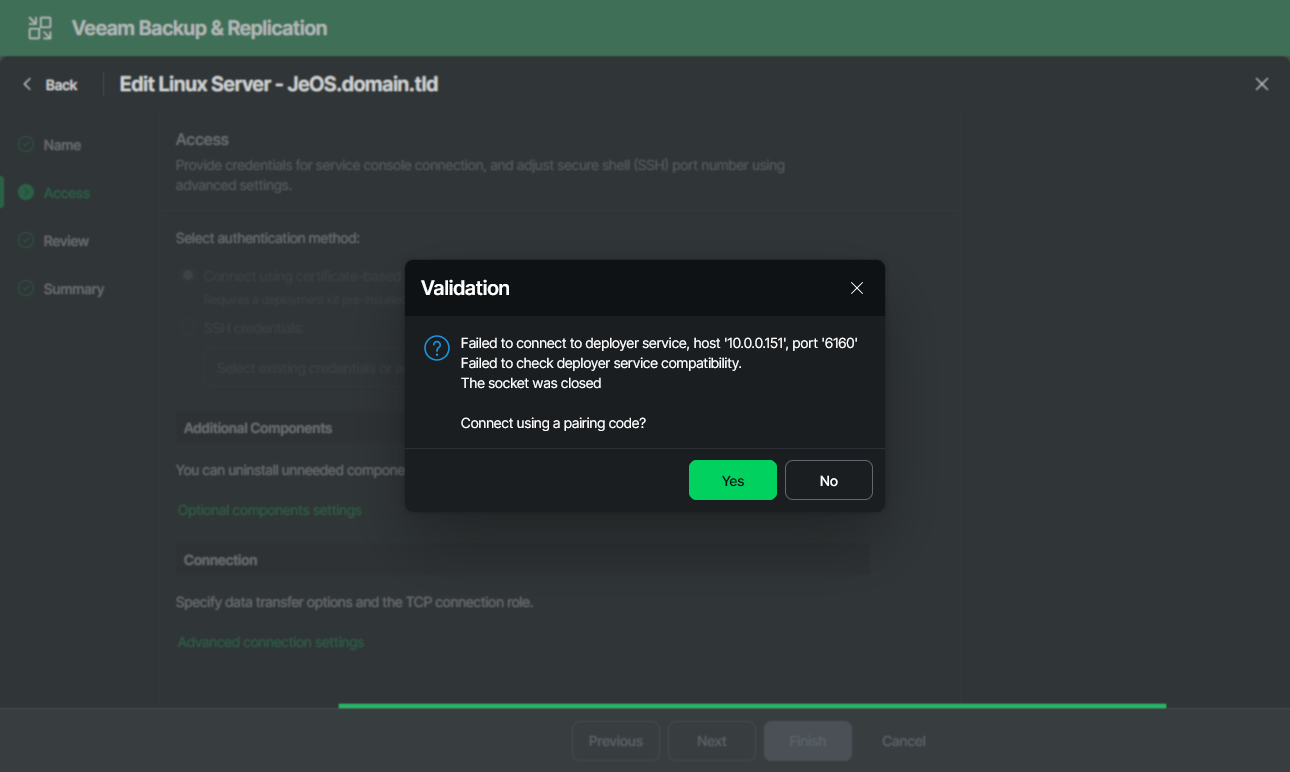

  2. With the entry within the Veeam Backup & Replication Console now updated so that the software will attempt to reach the Veeam Appliance using the correct hostname or FQDN, you must reinitialize the connection to the managed server.

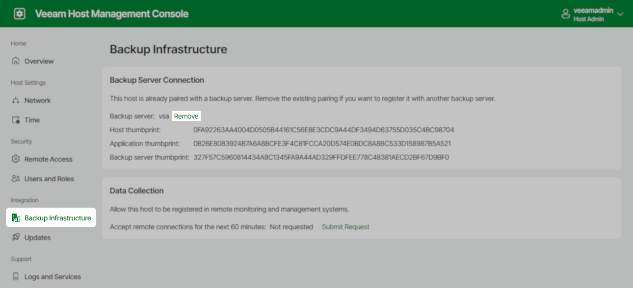

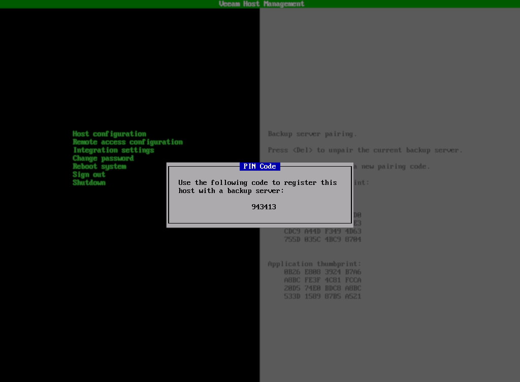

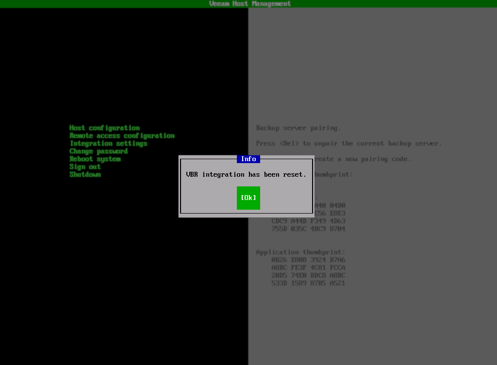

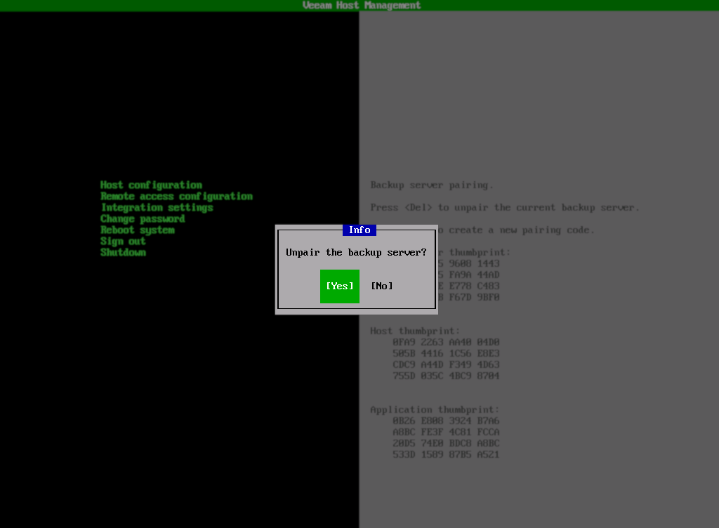

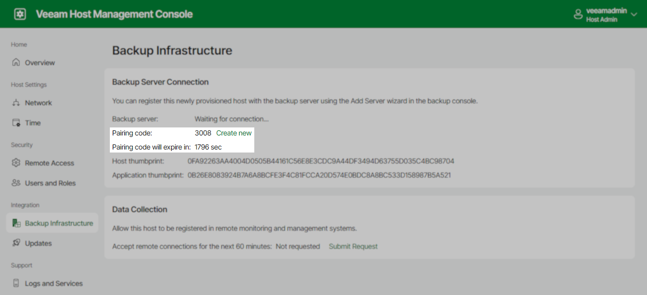

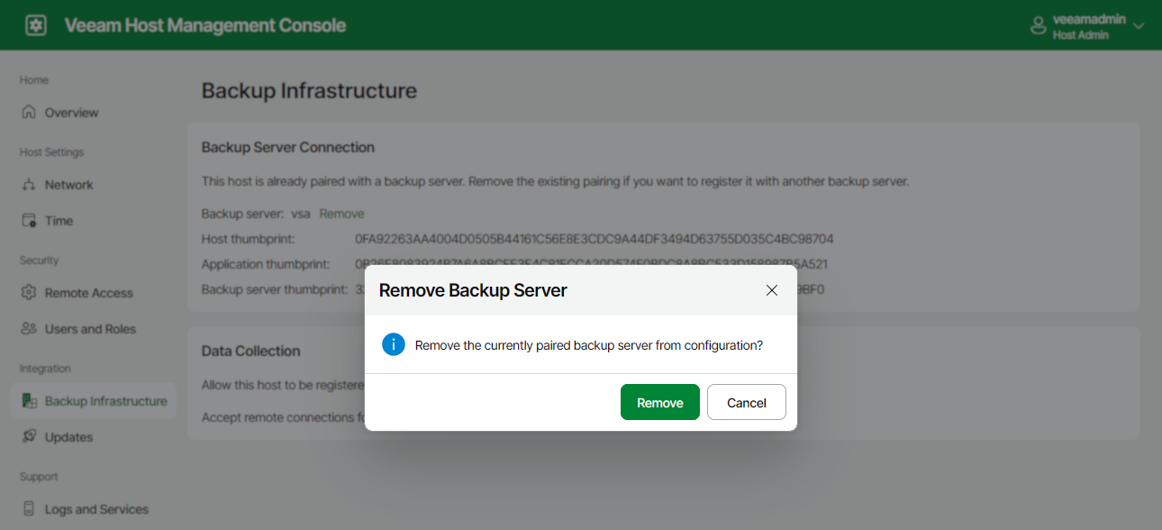

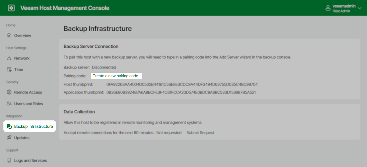

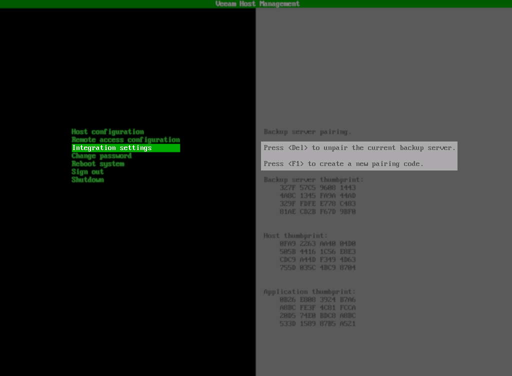

    1. Reset the pairing code on the Infrastructure Appliance.

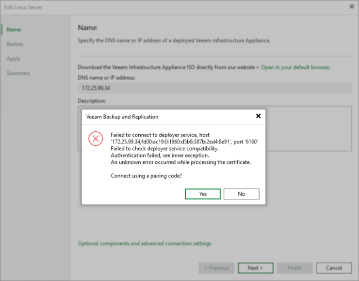

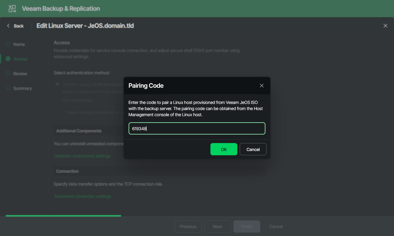

    2. Open the Veeam Backup & Replication Console and edit the Managed Server for the JeOS host whose hostname or FQDN was changed.

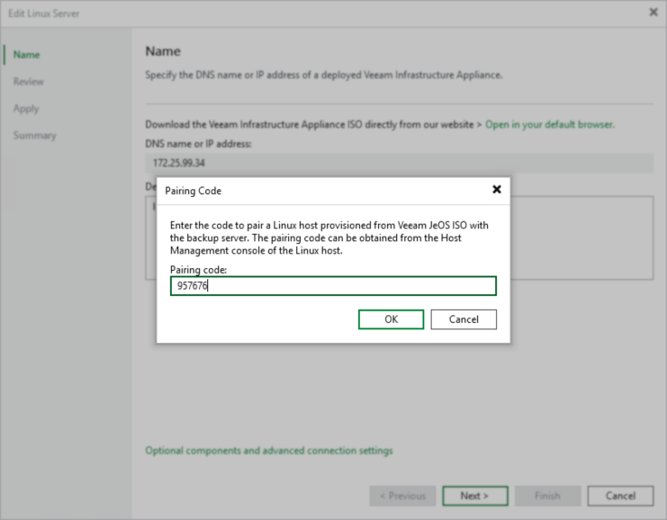

    3. Click Next through each step, and when prompted to "Connect using a pair code?" select Yes, and provide the Pairing Code.
      Note: The pairing code remains valid for 30 minutes.
