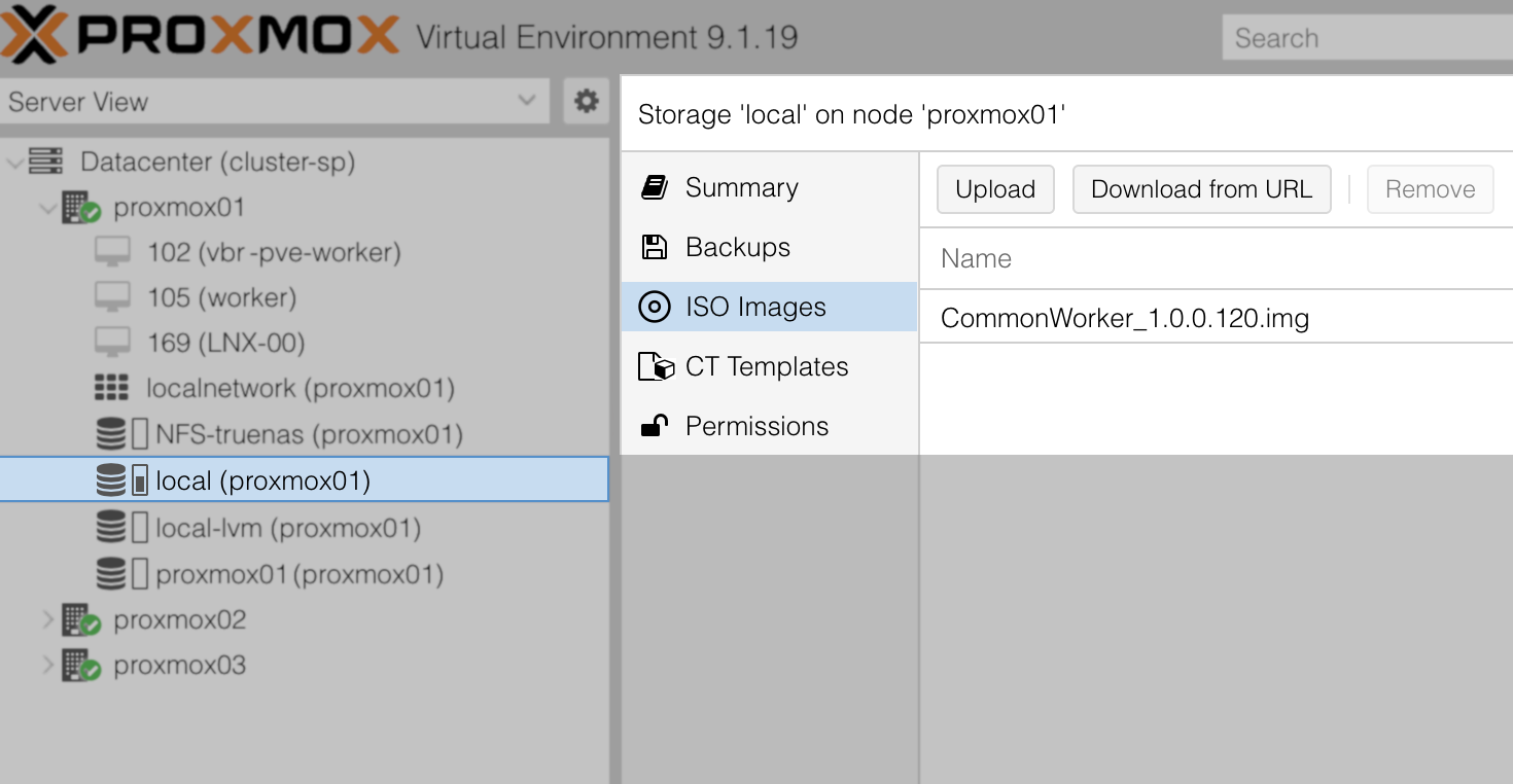

During deployment, the worker image is written to the ISO image directory of that storage, and the worker's cloud-init configuration is written to its snippets directory. By default, Veeam Backup & Replication uses the Proxmox VE local storage, which on a default installation carries both content types. This storage is separate from the storage where the worker VM's disks are mounted, so selecting a different storage for worker VMs does not remove the requirement.
The Proxmox VE web interface with the local storage selected on node proxmox01. The ISO Images tab lists the worker image file CommonWorker_1.0.0.120.img.

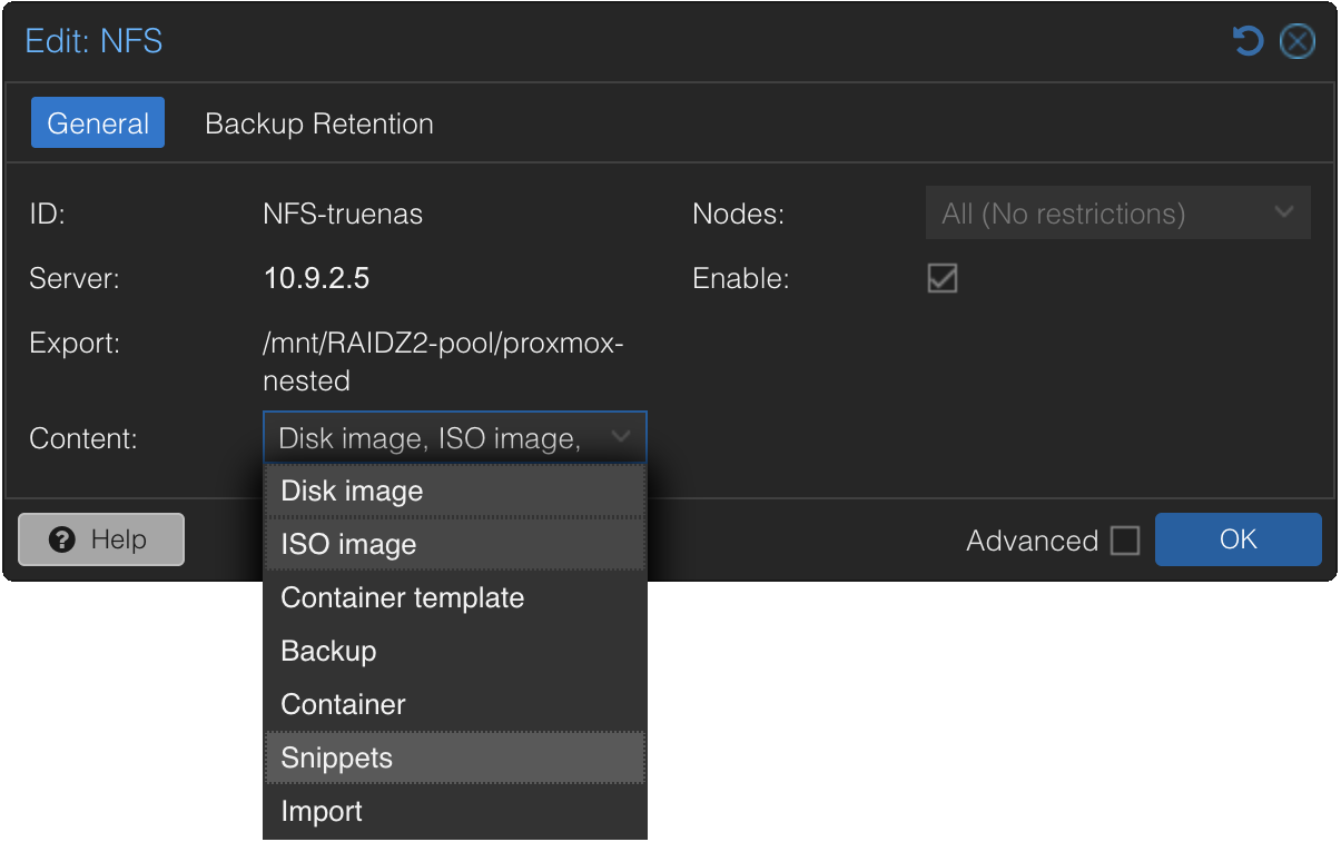

  1. In the Proxmox VE web interface, identify a file-level storage that is available on every node where a worker VM will be deployed. Confirm that both the ISO image and Snippets content types are enabled on it, and note the storage ID.
    In the example below, the storage ID is NFS-truenas.
The Proxmox VE storage edit dialog for an NFS storage. The ID field reads NFS-truenas, and the Content list shows ISO image and Snippets selected.

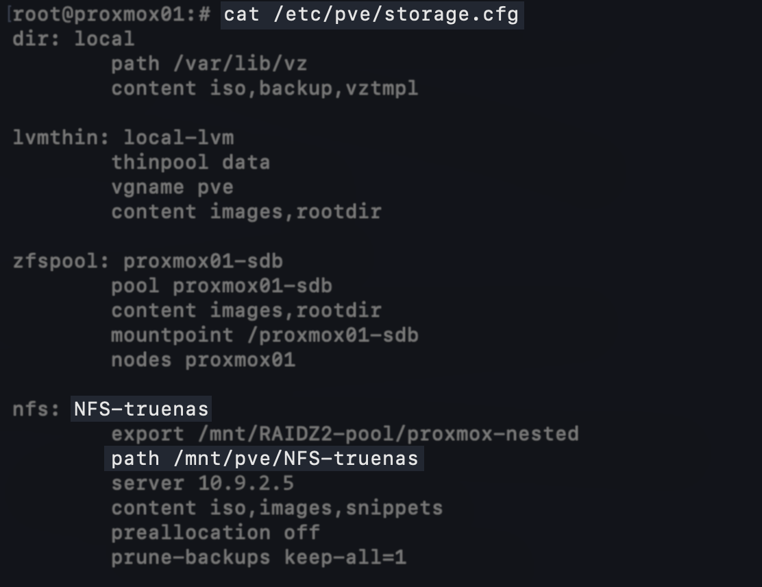

  1. On the Proxmox VE host, review the storage definition in /etc/pve/storage.cfg to determine its path value, for example:
    nfs: NFS-truenas
            export /mnt/RAIDZ2-pool/proxmox-nested
            path /mnt/pve/NFS-truenas
            server 10.9.2.5
            content iso,images,snippets
            preallocation off
            prune-backups keep-all=1
Terminal output of cat /etc/pve/storage.cfg on node proxmox01, listing the local, local-lvm, proxmox01-sdb, and NFS-truenas storage definitions. The nfs: NFS-truenas entry shows path /mnt/pve/NFS-truenas and content iso,images,snippets.

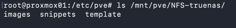

  1. Confirm that the expected directories exist at that path. In a multi-node cluster, confirm this on every node where a worker VM will be deployed.
    # ls /mnt/pve/NFS-truenas
    images  snippets  template
Terminal output of ls /mnt/pve/NFS-truenas showing the images, snippets, and template directories.

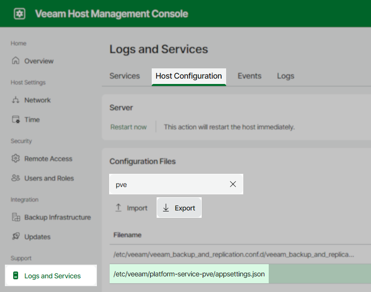

  1. Log in to the Veeam Host Management Console.
  2. Export the following configuration file using the Host Configuration tab found under Logs and Services:
    /etc/veeam/platform-service-pve/appsettings.json
Veeam Host Management Console showing the "Logs and Services" section under "Host Configuration," with the "pve" configuration file selected and the "Export" button highlighted. The file path "/etc/veeam/platform-service-pve/appsettings.json" is shown.

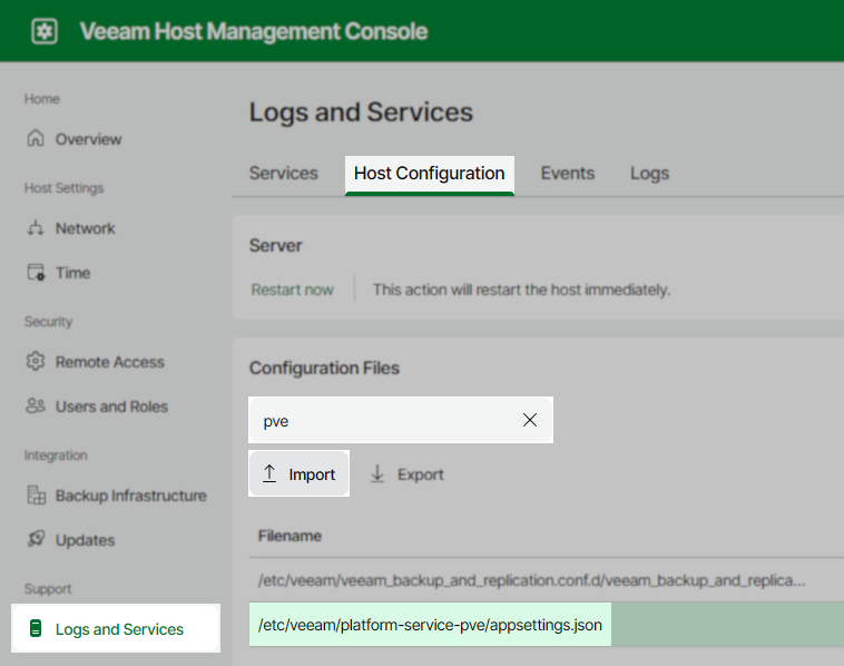

  5. Import the edited configuration file using the Host Configuration tab found under Logs and Services.
Veeam Host Management Console in "Logs and Services" under "Host Configuration," with "pve" configuration file selected and the "Import" button highlighted. The file path "/etc/veeam/platform-service-pve/appsettings.json" is shown.
Security Officer Approval Needed
After clicking Import, a message may appear stating that the change has been staged and requires the Security Officer to approve the setting import operation.
Please reference Performing Security Officer Tasks for more information.

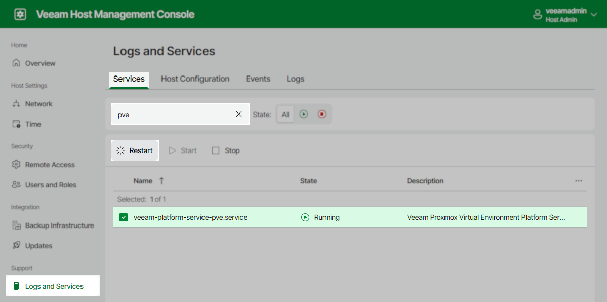

  1. Switch to the Services tab, search for the veeam-platform-service-pve.service service, select it and click Restart.
Veeam Host Management Console in "Logs and Services" under "Services," showing "veeam-platform-service-pve.service" selected and running, with the "Restart" button highlighted.
